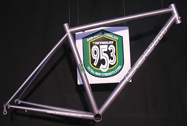

der rahmen von "Baum" soll übrigens 4000 Australische Dollar kosten:confused: muss das mal schnell in schweizer fränkli umrechnen:floet:
Baum & Reynolds
I'm going to kick off with my personal highlight of the show: Reynolds' new 953 stainless steel tubing, as built into a frame by Melbourne's Baum Cycles. Like just about every British rider my age (late 30's, thanks for asking) my first decent bike was made from Reynolds 531 steel, so I have a soft spot for the Birmingham, England tube maker.
However, the rush to build lighter and lighter frames has left steel behind in recent years. Aluminium and then carbon fiber have been the materials of choice for riders seeking a very light frame. Reynolds launched its 953 tubing just a couple of weeks ago and if it delivers on its promise it will put steel back in consideration. At the Bicycling Australia show, Baum had on display what the company's Jo Banks believes is one of just three 953 frames in the world at the moment (the other two tubesets went to Boston, USA builder Independent Fabrications). The weight: 1000g.
Baum's Jo Banks told Cyclingnews that this prototype frame was built to the exact same dimensions as "a well-known titanium company's 800g frame." In other words, this is a weight for a smallish 'medium' sloping frame.
