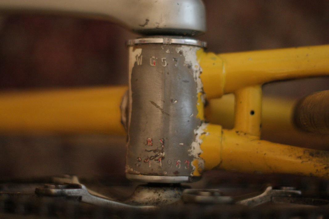

I'm ashamed to say, I've just found a glimpse of a serial number under a lot of paint ... Must sand it down.
You can try to doodle with a pencil over an piece of paper to make this visible. The slots will come out clearly with a little bit luck on the paper.
AW: Helfen Sie, Fahrrad zu identifizierenen
To appease my curiosity I got the nitromors out today. Had to cut through four layers of awful paint. BB shell is stamped:
WG57
RY
311963

Yeah, it's strange that the numbers on the bottom bracket and steerer match up... Maybe done after the build to 'marry' the two parts?

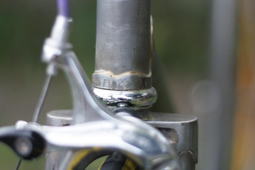

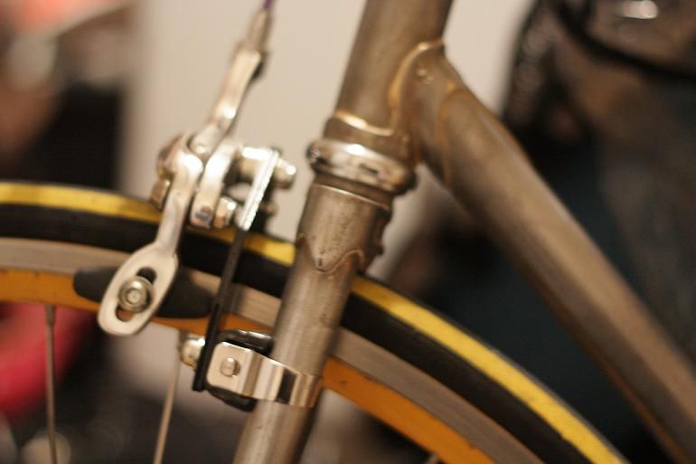

I figured I'd give this one last shot ... completely stripped back down to steel. Through a number of layers of paint came up with a stamp on the lug on the head tube. As well, the serial numbers matching (save for the '57') on the bb shell and front fork is complicating the whole old fork/newer frame possibility. I'm stumped. Anyone?

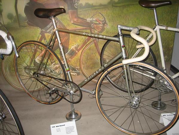

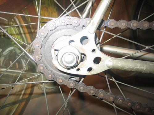

There is apparently this Hugo Rickert in the Zweirad/NSU museum. Interestingly it has very similar track ends... I know other Rickert's used similar plated forks (see picture) ... Does anyone know anything about the brand? There is very little historical, English information on Hugo Rickert.

i'm missing the rivet holes on the steerer tube, the older rickerts had them. and pictures of the fork crown would be great.
Here are the pictures:
Back on the serial number, I'm thinking 57 n the bottom bracket is cm's, the little RY is probably the brazer, and 311963vis perhaps 3/1/1963. Was there any manufacturer with the initials WG, or a track bike builders whose serial numbers started with WG?
