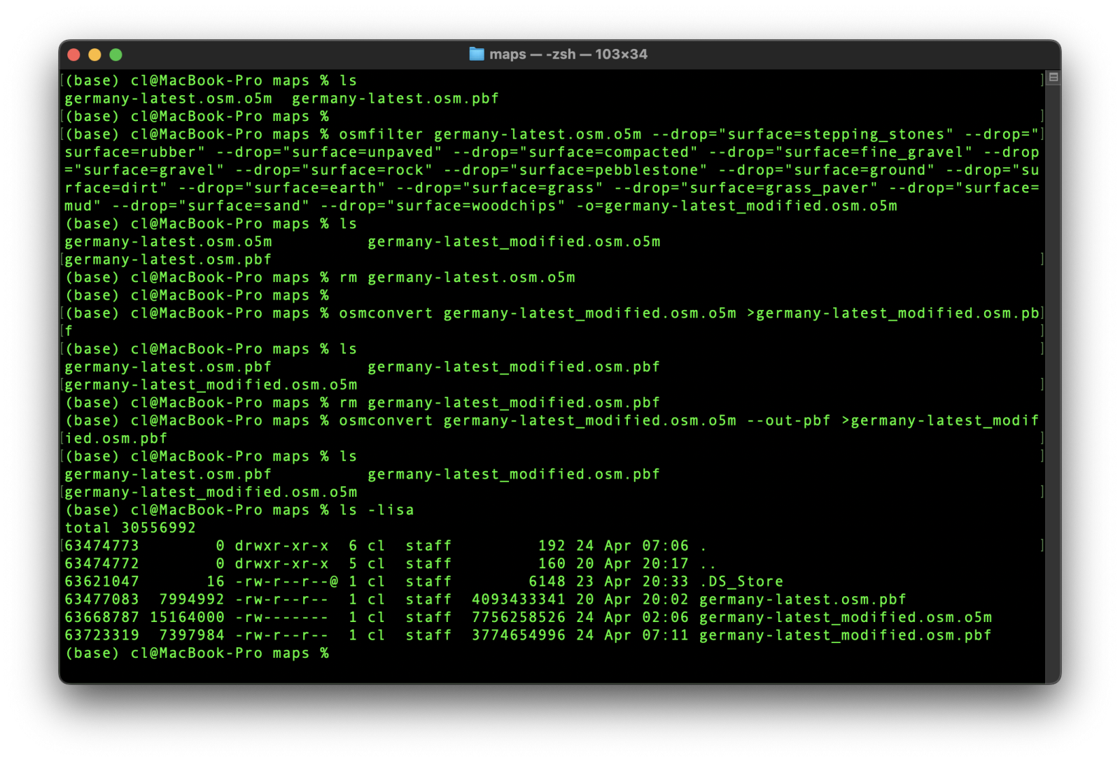

Here is how I did the "drops":

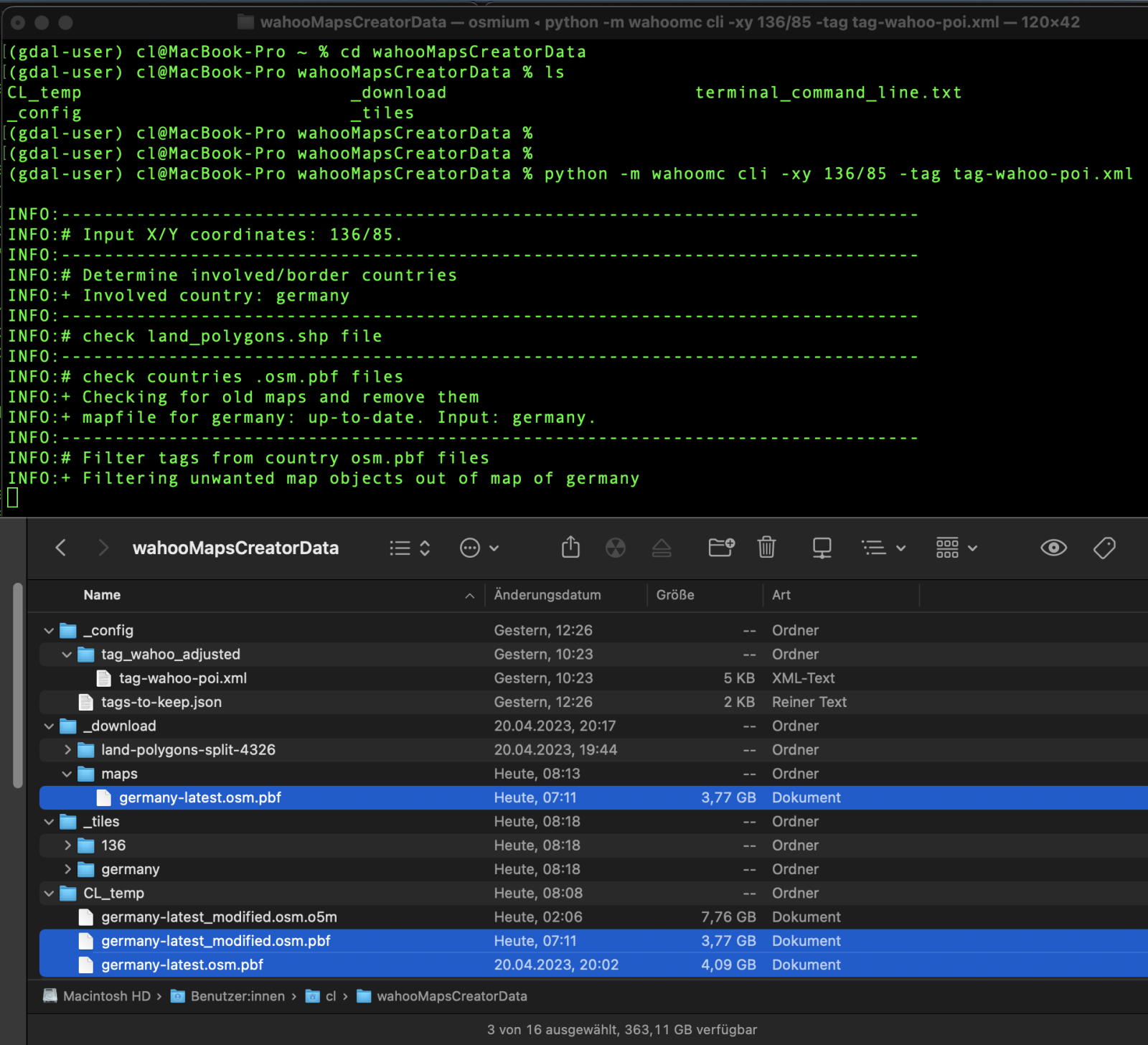

and the following for my local region by copying the modified map into the WMC default folder & renaming it to prevent the WMC from re-downloading the non-modified DE-map from the OSM server:
In result there is a file size reduction from 10.8MB to 9.8MB for now:

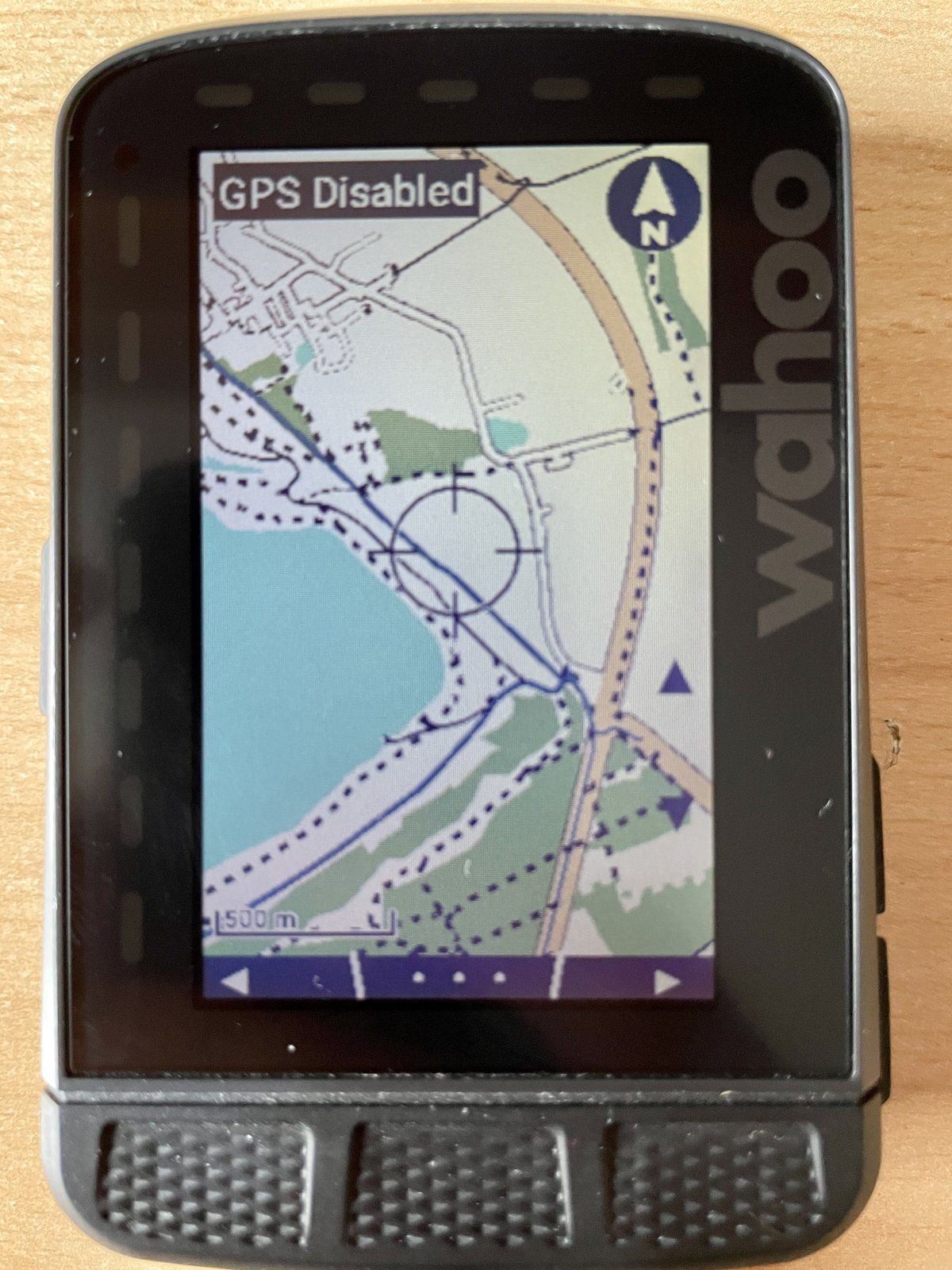

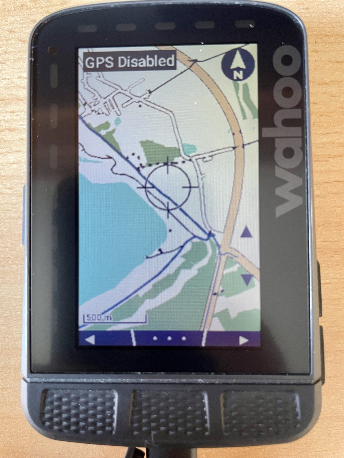

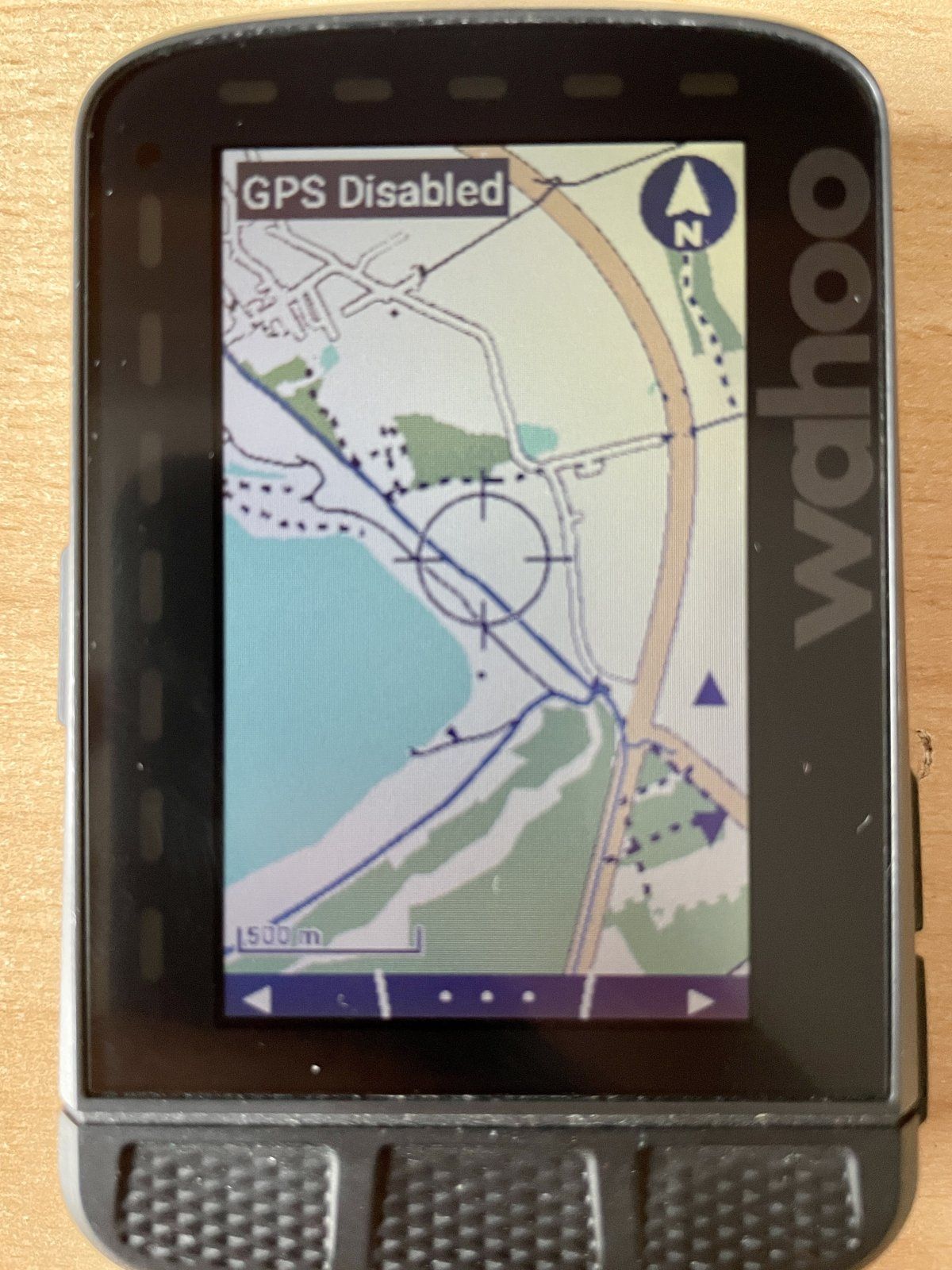

and the final result on my RoamV1 with a standard vtm-elemnt.xml taken from here containing unpaved path tags (unmodified map / modified map):
There still is some unpaved stuff shown, like this one, wich means I have to proceed with some more "drops".

the more "drops":
Bash:
osmfilter germany-latest.osm.o5m --drop="tracktype=grade2" --drop="tracktype=grade3" --drop="tracktype=grade4" --drop="tracktype=grade5" --drop="surface=stepping_stones" --drop="surface=rubber" --drop="surface=unpaved" --drop="surface=compacted" --drop="surface=fine_gravel" --drop="surface=gravel" --drop="surface=rock" --drop="surface=pebblestone" --drop="surface=ground" --drop="surface=dirt" --drop="surface=earth" --drop="surface=grass" --drop="surface=grass_paver" --drop="surface=mud" --drop="surface=sand" --drop="surface=woodchips" -o=germany-latest_modified_2.osm.o5m

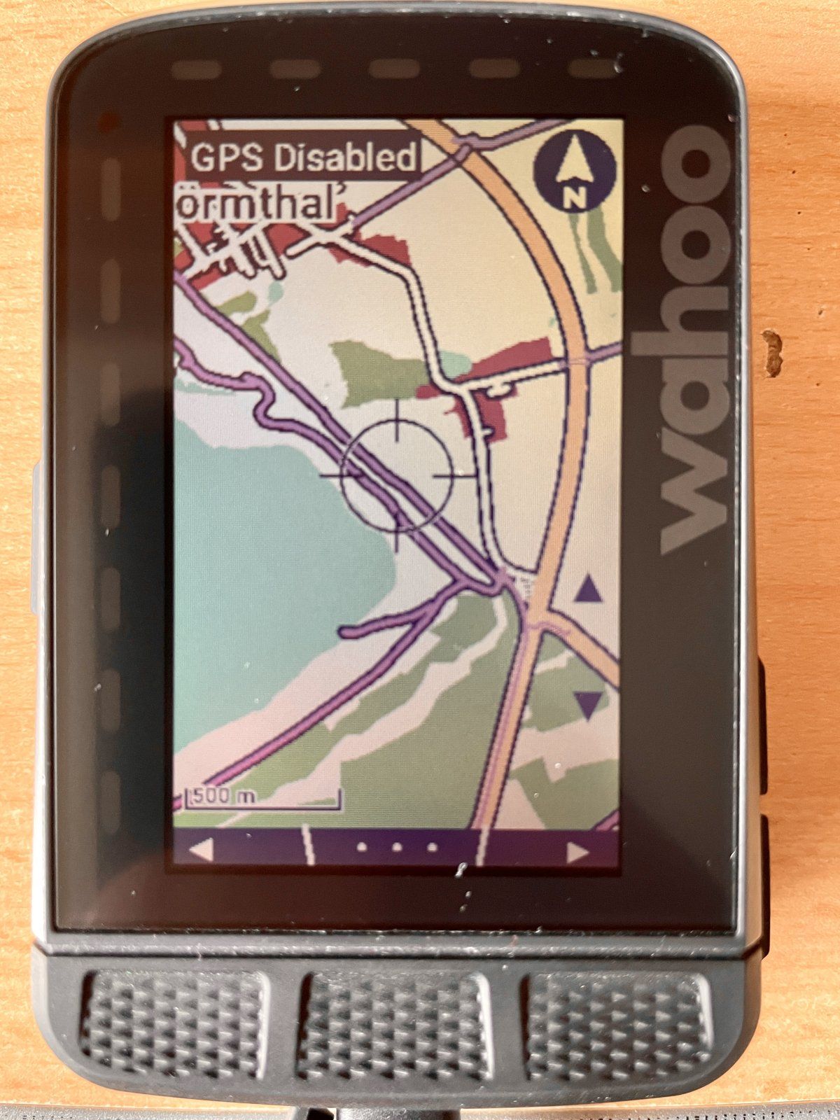

and the result on my RoamV1
  • with a standard vtm-elemnt.xml taken from here containing unpaved path tags (left side)
  • with my personal vtm-elemnt.xml containing only paved ones (right side):
left side: there are still a few possible unpaved tracks (dashline) wich are in OSM tagged without any surface or tracktype and therefore poor to be dropped from the map...
right side: only known (OSM tagged) paved tracks, paths and roads are displayed

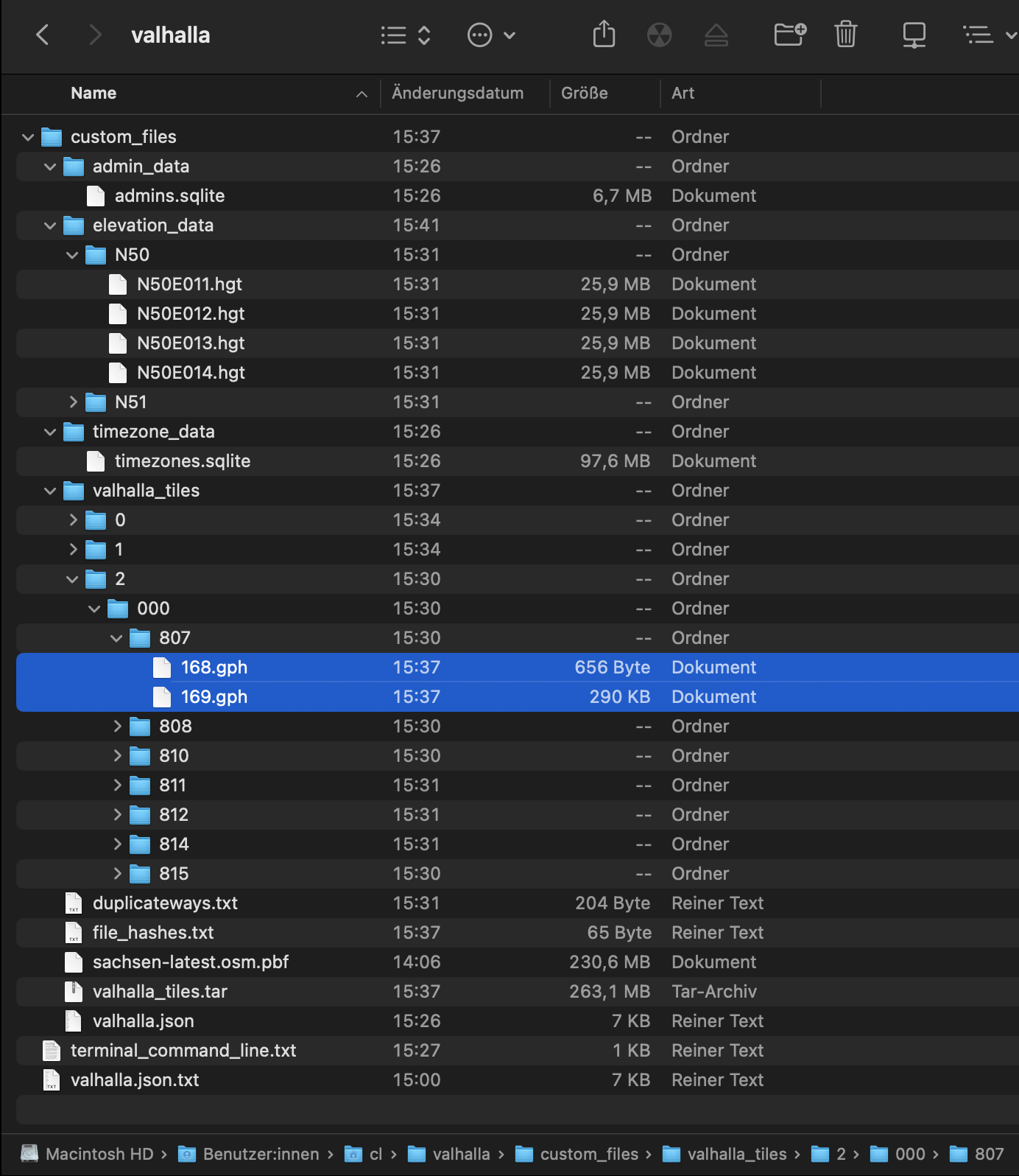

Next and hopefully last step is to create the depending routing tiles using the modified maps as shown above on the left & right side. But I don't have a clue how to do...
I had no access to my pc yesterday but that's what I was "afraid" of, not all paths will have a surface tag.
But you are pretty close to what you wanted! :daumen:
Personally only surprised to see my sample theme would not show the build up area's in red. It should use a red pattern. Going to check on that later.
Routing tiles: You should be able to use your pre-surface-filtered maps. I am pretty sure I already posted here how to create them. Can't find it back but in a nutshell this is how I do it (but I use a planet file as a source for completeness in border area's and that takes a lot of resources and time)
Docker desktop with this container: https://github.com/gis-ops/docker-valhalla
Create a folder to map to the container, custom_files in my example and copy your filtered pbf source map to it.
The command line I use (on windows) is this:
docker run -dt -e build_time_zones=True -e build_admins=True -e build_elevation=True -e min_x=-180 -e max_x=180 -e min_y=-90 -e max_y=90 -e use_tiles_ignore_pbf=False --name valhalla_gis-ops -p 8002:8002 -v d:/custom_files:/custom_files ghcr.io/gis-ops/docker-valhalla/valhalla:latest
to generate the tiles. Adjust the x/y for elevation data as needed to prevent a big download 😉
See the docs on the github page for more linux/mac like examples.
To start the container and just serve already created tiles:
docker run -dt -e use_tiles_ignore_pbf=True -e serve_tiles=True --name valhalla_gis-ops -p 8002:8002 -v d:/custom_files:/custom_files ghcr.io/gis-ops/docker-valhalla/valhalla:latest
Note, it can take a while to start. After that you can goto https://valhalla.github.io/demos/routing/index-internal.html and play around with it (using localhost on the left side) .
The valhalla.json.txt file is my settings file, rename it to valhalla.json. Should mostly be the Wahoo stuff. Place it in the mapped folder (d:\custom_files in my example).
Note: If you do not use the json file attached it will create routing tiles with default settings (not really bad) but it does cause the tile server part not to start (error about a http timeout).
Yes it does! Because you removed the "not wanted" roads in your file it will not be able to route over those anymore if you use it as a source for the routing tile generation.
It is I think more of a problem when you ride an mtb and it ignores gravel paths. (other way around from your situation)
For some reason, the result does not yet seem to look like it should on the Roam:
the related Docker logs:

2023-04-26 15:29:54 2023/04/26 13:29:54.023523 [INFO] Nodes processed. Sorting begin and end nodes by edge.
2023-04-26 15:29:55 2023/04/26 13:29:55.035417 [INFO] Sorting begin and end nodes done. Populating edges...
2023-04-26 15:29:55 2023/04/26 13:29:55.814440 [INFO] Finished with 1231732 graph nodes
2023-04-26 15:29:55 2023/04/26 13:29:55.876739 [INFO] Writing tile manifest to /custom_files/valhalla_tiles/tile_manifest.json
2023-04-26 15:29:55 2023/04/26 13:29:55.876905 [INFO] Reclassifying_V2 link graph edges...
2023-04-26 15:29:59 2023/04/26 13:29:59.332864 [INFO] Class: 0 exit count = 271
2023-04-26 15:29:59 2023/04/26 13:29:59.332927 [INFO] Class: 1 exit count = 148
2023-04-26 15:29:59 2023/04/26 13:29:59.332934 [INFO] Class: 2 exit count = 568
2023-04-26 15:29:59 2023/04/26 13:29:59.332938 [INFO] Class: 3 exit count = 459
2023-04-26 15:29:59 2023/04/26 13:29:59.332941 [INFO] Class: 4 exit count = 131
2023-04-26 15:29:59 2023/04/26 13:29:59.332944 [INFO] Class: 5 exit count = 25
2023-04-26 15:29:59 2023/04/26 13:29:59.332947 [INFO] Class: 6 exit count = 29
2023-04-26 15:29:59 2023/04/26 13:29:59.332950 [INFO] Class: 7 exit count = 0
2023-04-26 15:29:59 2023/04/26 13:29:59.361273 [INFO] Finished with 1841 reclassified.  Turn channel count = 789
2023-04-26 15:29:59 2023/04/26 13:29:59.501860 [INFO] Reclassifying ferry connection graph edges...
2023-04-26 15:30:00 2023/04/26 13:30:00.734327 [INFO] Finished ReclassifyFerryEdges: ferry_endpoint_count = 7, 7 edges reclassified.
2023-04-26 15:30:00 2023/04/26 13:30:00.780271 [INFO] Building 64 tiles with 6 threads...
2023-04-26 15:31:33 2023/04/26 13:31:33.376933 [INFO] Finished
2023-04-26 15:31:33 2023/04/26 13:31:33.395032 [INFO] Node Count = 1231732
2023-04-26 15:31:33 2023/04/26 13:31:33.395080 [INFO] Directed Edge Count = 3058972
2023-04-26 15:31:33 2023/04/26 13:31:33.395086 [INFO] EdgeInfo Count = 1536573
2023-04-26 15:31:33
2023-04-26 15:31:33 =================================
2023-04-26 15:31:33 = Download the elevation tiles =
2023-04-26 15:31:33 2023-04-26 13:31:33,553  INFO: Downloading tile N50E011.hgt
2023-04-26 15:31:33 2023-04-26 13:31:33,554  INFO: Downloading tile N50E013.hgt
2023-04-26 15:31:33 2023-04-26 13:31:33,558  INFO: Downloading tile N51E013.hgt
2023-04-26 15:31:33 2023-04-26 13:31:33,559  INFO: Downloading tile N50E012.hgt
2023-04-26 15:31:33 2023-04-26 13:31:33,562  INFO: Downloading tile N51E015.hgt
2023-04-26 15:31:33 2023-04-26 13:31:33,565  INFO: Downloading tile N51E012.hgt
2023-04-26 15:31:36 2023-04-26 13:31:36,193  INFO: Downloading tile N50E014.hgt
2023-04-26 15:31:36 2023-04-26 13:31:36,964  INFO: Downloading tile N51E014.hgt
2023-04-26 15:31:40 2023-04-26 13:31:40,370  INFO: Downloaded 8 tiles. Exiting.
2023-04-26 15:31:40
2023-04-26 15:31:40 ===============================
2023-04-26 15:31:40 = Enhancing the initial graph =
2023-04-26 15:31:40 2023/04/26 13:31:40.438981 [INFO] Start stage = enhance End stage = cleanup
2023-04-26 15:31:40 2023/04/26 13:31:40.439139 [INFO] Read OSMData unique_names from temp file
2023-04-26 15:31:40 2023/04/26 13:31:40.464516 [INFO] Done
2023-04-26 15:31:40 2023/04/26 13:31:40.464580 [INFO] Enhancing local graph...
2023-04-26 15:31:40 2023/04/26 13:31:40.529562 [INFO] Disabled default speeds assignment from config
2023-04-26 15:31:40 2023/04/26 13:31:40.535758 [INFO] Disabled default speeds assignment from config
2023-04-26 15:31:40 2023/04/26 13:31:40.540865 [INFO] Disabled default speeds assignment from config
2023-04-26 15:31:40 2023/04/26 13:31:40.544958 [INFO] Disabled default speeds assignment from config
2023-04-26 15:31:40 2023/04/26 13:31:40.547655 [INFO] Disabled default speeds assignment from config
2023-04-26 15:31:40 2023/04/26 13:31:40.548984 [INFO] Disabled default speeds assignment from config
2023-04-26 15:34:14 2023/04/26 13:34:14.179490 [INFO] Finished with max_density 19.221859
2023-04-26 15:34:14 2023/04/26 13:34:14.179546 [INFO] internal intersection = 4267
2023-04-26 15:34:14 2023/04/26 13:34:14.181213 [INFO] GraphFilter - nothing to filter. Skipping...
2023-04-26 15:34:14 2023/04/26 13:34:14.183031 [INFO] Transit directory not found. Transit will not be added.
2023-04-26 15:34:14 2023/04/26 13:34:14.183199 [INFO] HierarchyBuilder
2023-04-26 15:34:27 2023/04/26 13:34:27.549493 [INFO] Done HierarchyBuilder
2023-04-26 15:34:27 2023/04/26 13:34:27.550927 [INFO] Creating shortcuts on level 1
2023-04-26 15:36:11 2023/04/26 13:36:11.648134 [INFO] Finished with 35200 shortcuts
2023-04-26 15:36:11 2023/04/26 13:36:11.648246 [INFO] Creating shortcuts on level 0
2023-04-26 15:36:18 2023/04/26 13:36:18.878345 [INFO] Finished with 8804 shortcuts
2023-04-26 15:36:18 2023/04/26 13:36:18.954661 [INFO] Adding elevation to 74 tiles with 6 threads...
2023-04-26 15:36:24 2023/04/26 13:36:24.923457 [INFO] Finished
2023-04-26 15:36:24 2023/04/26 13:36:24.933774 [INFO] Adding Restrictions at level 2
2023-04-26 15:36:33 2023/04/26 13:36:33.087608 [INFO] --Forward restrictions added: 134
2023-04-26 15:36:33 2023/04/26 13:36:33.087675 [INFO] --Reverse restrictions added: 177
2023-04-26 15:36:33 2023/04/26 13:36:33.108285 [INFO] Adding Restrictions at level 1
2023-04-26 15:36:40 2023/04/26 13:36:40.102888 [INFO] --Forward restrictions added: 283
2023-04-26 15:36:40 2023/04/26 13:36:40.102958 [INFO] --Reverse restrictions added: 285
2023-04-26 15:36:40 2023/04/26 13:36:40.125216 [INFO] Adding Restrictions at level 0
2023-04-26 15:36:44 2023/04/26 13:36:44.958466 [INFO] --Forward restrictions added: 189
2023-04-26 15:36:44 2023/04/26 13:36:44.958525 [INFO] --Reverse restrictions added: 197
2023-04-26 15:36:44 2023/04/26 13:36:44.968968 [INFO] Finished
2023-04-26 15:36:44 2023/04/26 13:36:44.969056 [INFO] Validating, finishing and binning tiles...
2023-04-26 15:37:00 2023/04/26 13:37:00.024039 [INFO] Finished
2023-04-26 15:37:00 2023/04/26 13:37:00.024104 [INFO] Binning inter-tile edges...
2023-04-26 15:37:02 2023/04/26 13:37:02.863784 [INFO] Finished
2023-04-26 15:37:02 2023/04/26 13:37:02.863889 [WARN] Possible duplicates at level: 0 = 0
2023-04-26 15:37:02 2023/04/26 13:37:02.863942 [WARN] Possible duplicates at level: 1 = 0
2023-04-26 15:37:02 2023/04/26 13:37:02.863947 [WARN] Possible duplicates at level: 2 = 0
2023-04-26 15:37:02 2023/04/26 13:37:02.880875 [INFO] Cleaning up temporary *.bin files within /custom_files/valhalla_tiles/
2023-04-26 15:37:03 INFO: Successfully built files: /custom_files/sachsen-latest.osm.pbf
2023-04-26 15:37:03 INFO: Hashing files: /custom_files/sachsen-latest.osm.pbf
2023-04-26 15:37:03 INFO: Hashing file: /custom_files/sachsen-latest.osm.pbf
2023-04-26 15:37:03 f7eb6391e6aaf5343c01619e5f696f5bb035d99fabcdcabce58a5880b4717252
2023-04-26 15:37:37 2023-04-26 13:37:37,842  INFO: Finished tarring 74 tiles to /custom_files/valhalla_tiles.tar
2023-04-26 15:37:37 WARNING: User valhalla is running with sudo privileges. Try building the image with a host user's UID & GID.
2023-04-26 15:37:38 INFO: Found config file. Starting valhalla service!
2023-04-26 15:37:38 2023/04/26 13:37:38.583749 [INFO] Tile extract successfully loaded with tile count: 74
2023-04-26 15:37:38 2023/04/26 13:37:38.585575 [INFO] Tile extract successfully loaded with tile count: 74
2023-04-26 15:37:38 2023/04/26 13:37:38.585947 [INFO] Tile extract successfully loaded with tile count: 74
2023-04-26 15:37:38 2023/04/26 13:37:38.586024 [INFO] Tile extract successfully loaded with tile count: 74
2023-04-26 15:37:38 2023/04/26 13:37:38.586057 [INFO] Tile extract successfully loaded with tile count: 74
2023-04-26 15:37:38 2023/04/26 13:37:38.586473 [INFO] Tile extract successfully loaded with tile count: 74
2023-04-26 15:37:38 2023/04/26 13:37:38.586586 [INFO] Tile extract successfully loaded with tile count: 74
2023-04-26 15:37:38 2023/04/26 13:37:38.586587 [INFO] Tile extract successfully loaded with tile count: 74
2023-04-26 15:37:38 2023/04/26 13:37:38.586986 [INFO] Tile extract successfully loaded with tile count: 74
2023-04-26 15:37:38 2023/04/26 13:37:38.587201 [INFO] Tile extract successfully loaded with tile count: 74
2023-04-26 15:37:38 2023/04/26 13:37:38.587409 [WARN] (stat): /custom_files/traffic.tar No such file or directory
2023-04-26 15:37:38 2023/04/26 13:37:38.588097 [WARN] Traffic tile extract could not be loaded
2023-04-26 15:37:38 2023/04/26 13:37:38.588375 [WARN] (stat): /custom_files/traffic.tar No such file or directory
2023-04-26 15:37:38 2023/04/26 13:37:38.588391 [WARN] Traffic tile extract could not be loaded
2023-04-26 15:37:38 2023/04/26 13:37:38.589127 [INFO] Tile extract successfully loaded with tile count: 74
2023-04-26 15:37:38 2023/04/26 13:37:38.593960 [WARN] (stat): /custom_files/traffic.tar No such file or directory
2023-04-26 15:37:38 2023/04/26 13:37:38.594025 [WARN] Traffic tile extract could not be loaded
2023-04-26 15:37:38 2023/04/26 13:37:38.596609 [WARN] (stat): /custom_files/traffic.tar No such file or directory
2023-04-26 15:37:38 2023/04/26 13:37:38.596650 [WARN] Traffic tile extract could not be loaded
2023-04-26 15:37:38 2023/04/26 13:37:38.598504 [WARN] (stat): /custom_files/traffic.tar No such file or directory
2023-04-26 15:37:38 2023/04/26 13:37:38.598703 [WARN] Traffic tile extract could not be loaded
2023-04-26 15:37:38 2023/04/26 13:37:38.599864 [WARN] (stat): /custom_files/traffic.tar No such file or directory
2023-04-26 15:37:38 2023/04/26 13:37:38.599968 [WARN] Traffic tile extract could not be loaded
2023-04-26 15:37:38 2023/04/26 13:37:38.601485 [WARN] (stat): /custom_files/traffic.tar No such file or directory
2023-04-26 15:37:38 2023/04/26 13:37:38.601537 [WARN] Traffic tile extract could not be loaded
2023-04-26 15:37:38 2023/04/26 13:37:38.602833 [WARN] (stat): /custom_files/traffic.tar No such file or directory
2023-04-26 15:37:38 2023/04/26 13:37:38.602864 [WARN] Traffic tile extract could not be loaded
2023-04-26 15:37:38 2023/04/26 13:37:38.604031 [WARN] (stat): /custom_files/traffic.tar No such file or directory
2023-04-26 15:37:38 2023/04/26 13:37:38.604120 [WARN] Traffic tile extract could not be loaded
2023-04-26 15:37:38 2023/04/26 13:37:38.605107 [WARN] (stat): /custom_files/traffic.tar No such file or directory
2023-04-26 15:37:38 2023/04/26 13:37:38.605350 [WARN] Traffic tile extract could not be loaded
2023-04-26 15:37:38 2023/04/26 13:37:38.608190 [WARN] (stat): /custom_files/traffic.tar No such file or directory
2023-04-26 15:37:38 2023/04/26 13:37:38.608370 [WARN] Traffic tile extract could not be loaded
2023-04-26 15:37:38 2023/04/26 13:37:38.609587 [INFO] Tile extract successfully loaded with tile count: 74
2023-04-26 15:37:38 2023/04/26 13:37:38.610768 [WARN] (stat): /custom_files/traffic.tar No such file or directory
2023-04-26 15:37:38 2023/04/26 13:37:38.610823 [WARN] Traffic tile extract could not be loaded

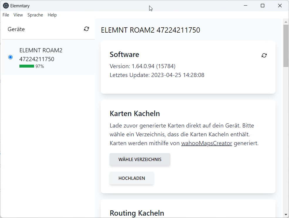

ran three times, the last time quoted above using the original pbf from Geofabrik
I think I need some helping input.
Looks good to me, but did you try (don't see it in your output) to use them from the pc at https://valhalla.github.io/demos/routing/index-internal.html ?
Ohh wait, I see what you mean, you still have to compress them!
In my program I copy the needed tiles to a folder and compress them like this:
cmd = ['7za', 'a', '-tzip', wanted_map+f'-routing' , os.path.join(f'{OUT_PATH}', f'{wanted_map}-routing', f'*')]
at
https://github.com/Ebe66/Windows-Wa...lob/master/wahoo-map-creator-osmosis.py#L1077
Copy the needed tiles including structure to a subfolder from the folder where 7za is located so 2\000\etc
and from the command line run 7za a -tzip compressed excisting_name_of_output_folder name_of_folder_containing_the_routing_tiles\*
Have to eat first or I would try, but that should be it
Erwin ist in der Google Groups ordentlich aktiv: etwas schwierig zu lesen - aber interessant... Einer schon mal was von der ELMTARY.app und hier von Viacheslav Tykhanovskyi gehört? Irre Entwicklung....
