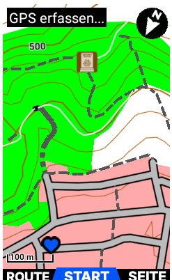

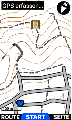

Thx for your work, I am using your maps for years now!
But with the newest maps I've some "visual problems": Most of the green forests disapeared and also the "red village house color", it's looking more than a stock map on my Roam v2. I am using your vtm sample theme, but also tried other themes like Uwe's, but it seems it's a map issue.
So I want to roll back to the prev version, but I had overwritten the files. Is there any source to get the old files from summer 24? They were working as expected. or is is just another problem?

When I am using the "germany-zoom-appear-12" Map Pack everything is back again. So there is a "backup", but when I am trying the newest map release, the visuals are back like on my screen.
There was a difference between Uwe's and your theme, but it's was only marginal.
Perhaps the problem is, that I am not using your theme. Can you give me the exact link to your newest version for Roam v2?
This is a screenshot with the germany-zoom-appear-12 map and the same theme.

Not that it helps you, but here is a screenshot of my surroundings on my Ace:
And a, differently orientated, screenshot of the same area in Cruiser:
The theme I'm using is identical to the one on the OneDrive here:
I just did a binary compare to confirm they are the same.
I don't expect to see anything else than you do, but would you mind sharing which tile you use and/or the exact coordinates?
Can anybody else confirm (or preferably not 😉) this issue?
Good morning,
Tile is Rheinland Pflalz / 50.40379611473804, 7.146115874903611
Same here, it seems like there is a lot of forest missing in the Rheinland Pflalz map area.
After i copied the germany-zoom-appear-12 map back again, it seems to be ok.
