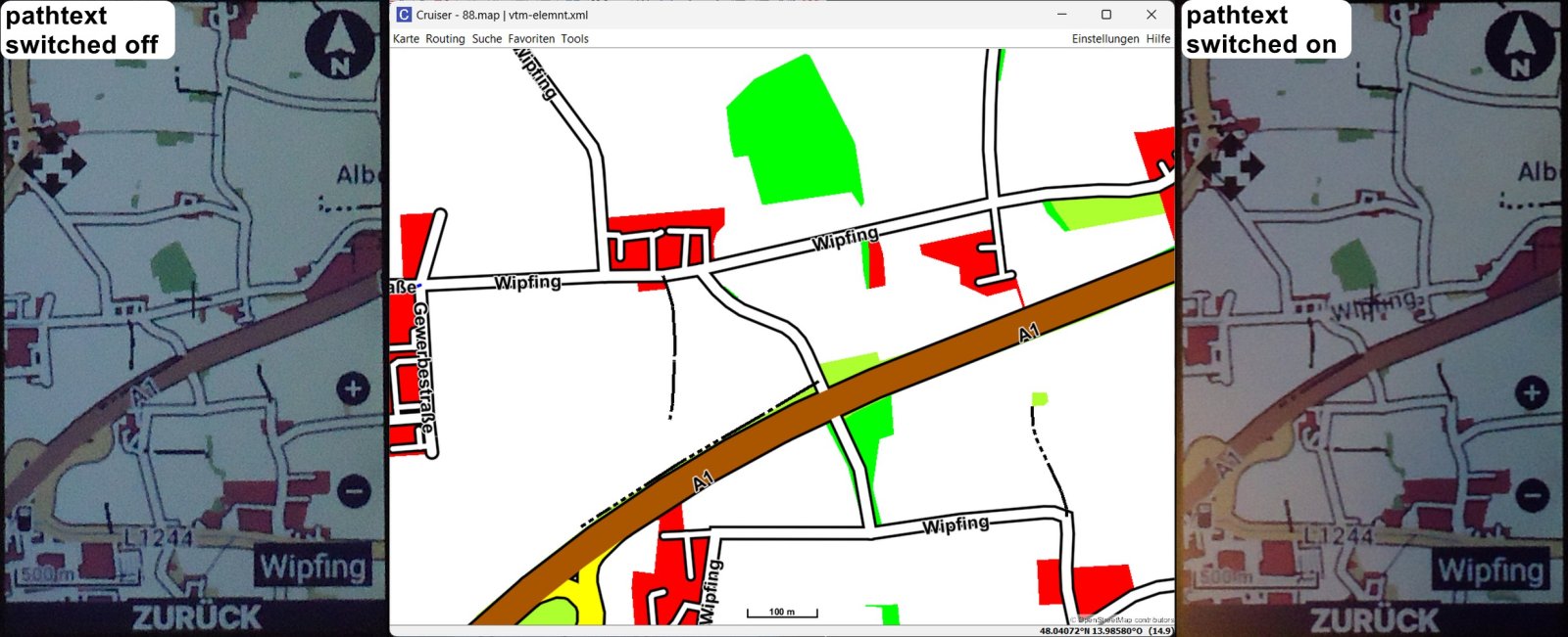

Can you share any details? Place=Hamlet is a maps setting. And it's included in the map generation. Valhalla (or our adapted Wahoo version/fork of it) is pretty much a box at which you throw a osm file and routing comes out. Speaking from the top of my mind here, but configuration is minimal and I am 99,999 % sure it doesn't use the place= etc kind of configuration, it just uses what's in the osm file and what I use as input are the official complete OpenStreetMap planet files. I don't have a routing capable Wahoo device so I don't even know how it works on the devices. Can you write out what is different between the Wahoo and mine version with example hamlet's?
Yes, correct, played around a bit and found the problem: Sometimes the streets in and around a hamlet are tagged with the name of the hamlet. Example for hamlet "Wipfing":
Obviously this taggings were removed from a few hamlets around my area, because in the new routing tiles and in osm they are missing:
So everything is o. k. There must be even more info in the new tiles, because the filesizes are bigger.
