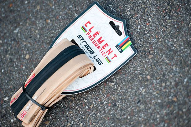

I rate this tire 2/5 Not Recommended because you can find tires with a similar tread puncture resistance, lower rolling resistance, stronger sidewalls and even a lower price. Take a look at the road bike overview page and use the filters to find which tires might suit you better.:rolleyes:
https://www.bicyclerollingresistance.com/road-bike-reviews/clement-strada-lgg-2017
