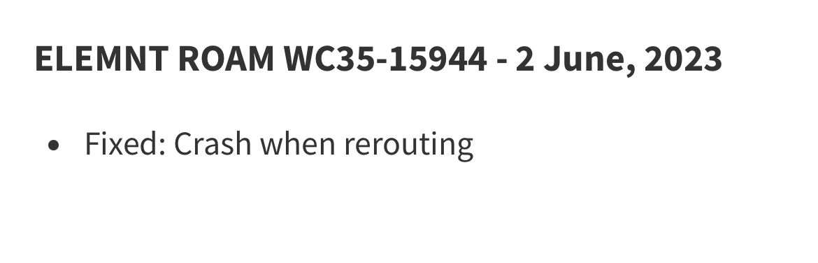

Ja, denke schon - Hatte mit dem Beta-Files keine Abstürze mehr ... Bisher :) Drück mir bitte die Daumen! Sitze eben am MacBook ohne Zugriff auf Ubuntu. Du meinst die Höhenlinien?

Hope Deepl translater does a good job ;-) No, the contour lines are a map feature. They are purely visual.
I mean real height data inside the routing tiles. It took a long time before I stumbled upon a post that cleared things up for me (a bit). Valhalla (also the gis-op version/scripts do NOT add elevation to the tiles which is needed for the Summit Freeride feature. Or put it differently what is needed to prevent crashes.
On the pc (webserver part) the software gets the height info when using the test "site" directly from the .hgt files which are not on the device.
What is added when they say "adding elevation to the tiles" is a grade (angle) not a height!
Wahoo made an own version of Valhalla that does add elevation and its published on their github, but intentional or not, there are some syntax error in there Intyre with a little motivation from me ;-) got it working (fingers crossed). You can find it here: https://github.com/Intyre/valhalla-wahoo in the fix/docker branch. Don't let the title fool you, it can be build on Ubuntu and I am running it now.
I used this guide to build and run it https://gis-ops.com/valhalla-part-3-how-to-build-with-elevation-support-on-ubuntu/
