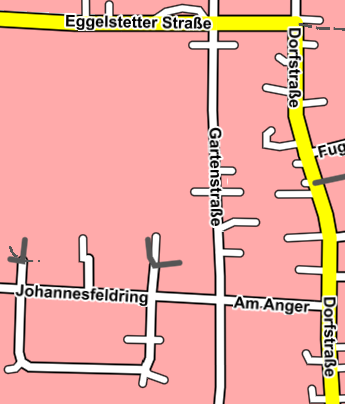

Weiß zufällig jemand den Befehl in der vtm-elemnt.xlm um die Straßennamen über die Straße (wenn waagrecht) bzw. an der Seite der Straße (wenn senkrecht) schreiben zu lassen ? Anzeigen lassen kann ich sie schon. Sie stehen dann aber in der jeweiligen Straße drin. Bzw. darüber habe ich auch schon geschafft. Aber dann steht der Name auch bei senkrechten Straßenzügen immer waagrecht.
You don't say what you are using now, but pathText does a decent job for canals and the likes for me.

Currently I'm using pathText and caption. As far as I know is pathText only able to print the names into the Street there is no location like "above" or "beyond" possible.
With caption you are able to use a location, but then the printtout is only horizontaly. But "Gartenstraße" should be printed vertically.
This are all possible options for pathText, don't know what dy does:

Me neither, I hoped the dy was something like Delty Y positioning but using values from +/-20 (used in an example I found) to +/- 120 made no visible difference at all.
This is was a also thought and tested. But didn‘t work. No Problem. Maybe I will give it an other try.
