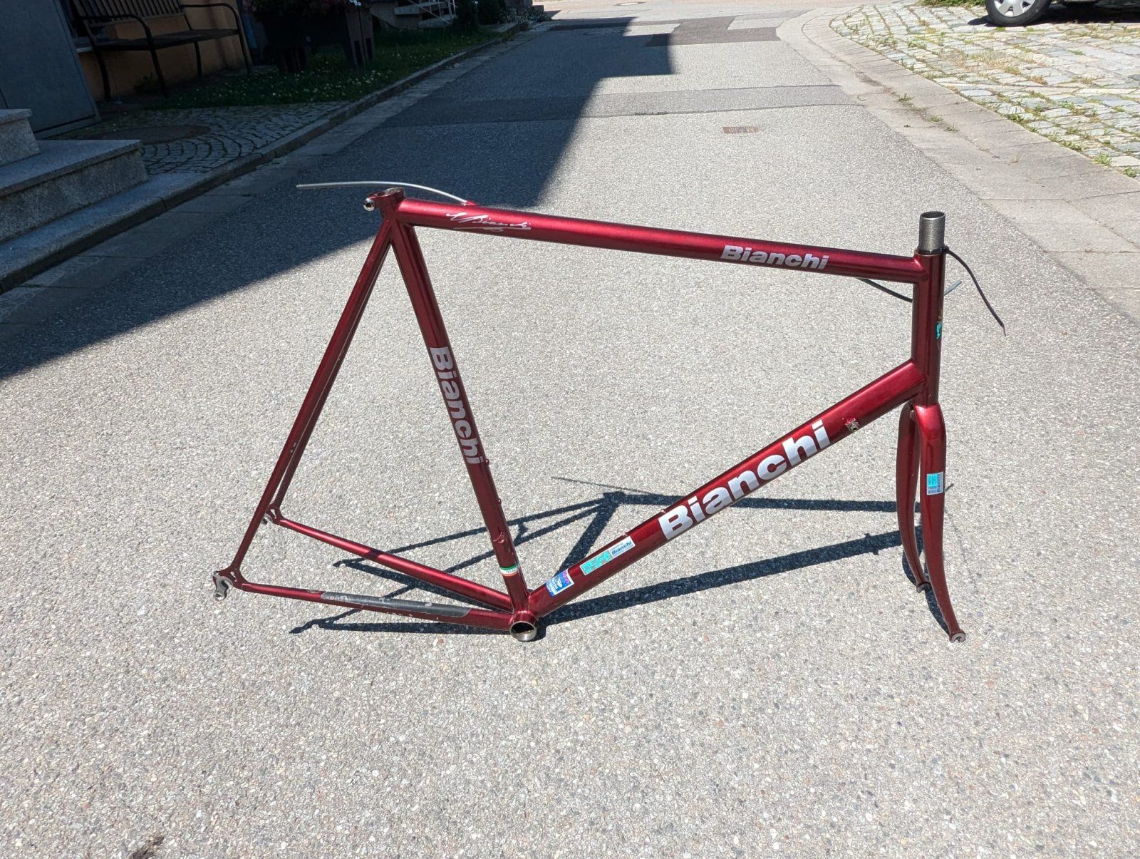

Für die Wissenschaft:
96/97 Bianchi MEGA aus Dedacciai ZERO Tubing RH 62 (60 c-c) OR 58 (c-c)
Gewicht Gabel: 664 g
Gewicht Rahmen: 1815 g

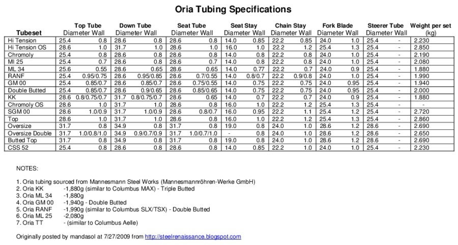

also eine Übersicht auf die diversen Rohrmaterialien wär schon klasse - wir haben diese Daten ja schon hier - allerdings eher verteilt. Was ich meine wär vllt. so was.
Bicycle Frame Tube Information
https://www.strongframes.com/tubing-information/
Zitat: ein Auszug...:
Below is a table I’ve maintaied for about 17 years. Somehow, it didn’t make it to my last site, so I got it out, brushed it off, and updated it a bit. There are some tubes that didn’t make it from the older version because they are no longer manufactured and a few new items have been added. ...[,,,],,,, For those of you who are interested in older tubes, we’ve resurrected a tube spec table from our 1999 website that can be found here.
Bicycle Frame Tube Information (1999)
http://www.strongframes.com/bicycle-frame-tube-information-1999/
Here is a tube spec table we’ve resurrected from our 1999 website. We Figured it would be fun for those that have been around a while or if you are looking at an older bike and wanted more info about it.
seht euch die Tabellen an von Strongframes.. :Quelle: https://www.strongframes.com/tubing-information/
