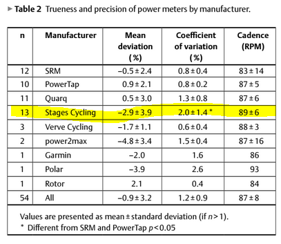

Klar, es gab gerade in der ersten Generation Qualitätsprobleme aber die Genauigkeit des Gerätes wird niemand ernsthaft anzweifeln.
Doch!!!!
Auch wenn ich mich wiederhole!!
Abstract
The aim of this study was to compare the accuracy among a high num-
ber of current mobile cycling power meters used by elite and recrea-
tional cyclists against a first principle-based mathematical model of
treadmill cycling. 54 power meters from 9 manufacturers used by 32
cyclists were calibrated. While the cyclist coasted downhill on a motor-
ised treadmill, a back-pulling system was adjusted to counter the down-
hill force. The system was then loaded 3 times with 4 different masses
while the cyclist pedalled to keep his position. The mean deviation
(trueness) to the model and coefficient of variation (precision) were
analysed. The mean deviations of the power meters were –0.9 ± 3.2%
(mean ± SD) with 6 power meters deviating by more than ± 5%. The co-
efficients of variation of the power meters were 1.2±0.9% (mean±SD),
with Stages varying more than SRM (p < 0.001) and PowerTap
(p < 0.001). In conclusion, current power meters used by elite and rec-
reational cyclists vary considerably in their trueness; precision is gener-
ally high but differs between manufacturers.
Calibrating and adjusting
the trueness of every power meter against a first principle-based refer-
ence is advised for accurate measurements.
upload_2017-5-16_15-56-24-png.450410
Aus; Maier T et al. Accuracy of Cycling Power ... Int J Sports Med 2017.
Die Studie zeigt nicht nur, dass die Stages-Teile im Durchschnitt eine größere Abweichung "nach unten" zur tatsächlichen Leistung aufweisen als etwa SRM, Quarq und Powertap, sondern, dass die Reproduzierbarleit der Ergebnisse je Powermeter statistisch signifikant schlechter ist als bei SRM und Powertap.
Zudem ist das auch nicht die einzige Arbeit, die gewissen Probleme von Stages adressiert.
Diese Studie fand ebenfalls eine durchaus beachtliche Abweichung "nach unten" von Stages beim Vergleich mit einem SRM
http://www.jsc-journal.com/ojs/index.php?journal=JSC&page=article&op=view&path[]=162
Wenn diese stabil wäre, wäre das nur ein kleineres Problem, dagegen sprechen aber die Ergebnisse der oben zitierten Untersuchung sowie auch die Folgende:
http://www.tandfonline.com/doi/abs/10.1080/19346182.2015.1108979?src=recsys&journalCode=rtec20
Hier stellte man beim Mountainbiking beim Vergleich von Stages, Powertap und Quarq fest, dass Stages offenbar einen größeren Anteil von cNullwerten produziert, was möglicherweise auf den Einsatz von Accelerometern zur Ermittlung der Cadence zurückzuführen ist. Offenbar hat die Beschaffenheit des Streckenuntergrundes also EInfluss auf Leistungsmessung bei Systemen mit Beschleunigungssensoren (kann einen auch nicht überraschen, wenn man drüber nachdenkt ... .)

Danke für den Link mit der Zusammenfassung. Interessant jedoch, dass diese dem Stages zu niedrige Werte attestieren? Das widerspricht allem, was oben und durch andere geschrieben worden ist. Zudem: es geht dort um Messungen mit dem MTB im Gelände; Du schreibst es ja selber. Bei sehr "harten" Fahrten über Kopfsteinpflaster (mit dem Rennrad) habe ich in meinen Daten auch schon einzelne Peaks gefunden. Das betrachte ich jedoch als irrelevanten Meßfehler. Ob das Ergebnis so also übertragbar ist kann man erst einmal anzweifeln.
