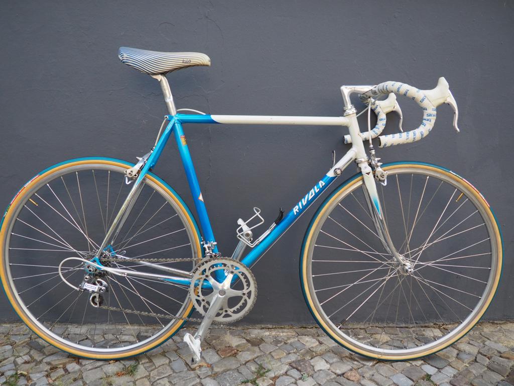

correct0 mundo. :D
Ravi (P. M.) meets Rivola!
nach Peloso (Masi del Piemont') und Monti (@Baggio, founded by Carlo Monti 1935, brazed by Losa in '80s).
