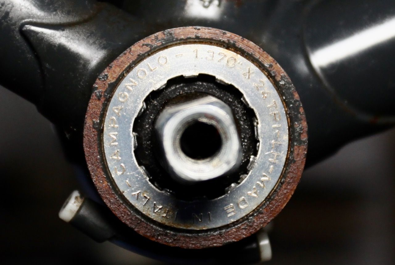

aHR0cHM6Ly9mb3Rvcy5yZW5ucmFkLW5ld3MuZGUvZjMvNS81MDUvNTA1MDc0LWE5aDhlbGdkNzhiYS1jcm9zc3JvYWRzXzIwLWxhcmdlLmpwZw.jpg
technisch irrelevant, abba gelb ;-)
